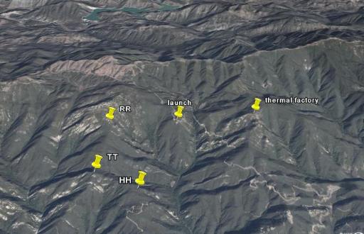

First of all, launch: getting up above it is nice, but not all that important.
If I’m not at least maintaining altitude after my first 360 I’m gone. And, if
I’m at the back of the launch line and I see that the Thermal Factory is working
I’ll just head straight over to it and not bother with the stuff near take-off.
Sometimes we get an early east flow, so instead of going directly to the TF you
might want to head to the Holy Hills first if you’re not getting up at launch
with the idea of using the RR as the starting point east.

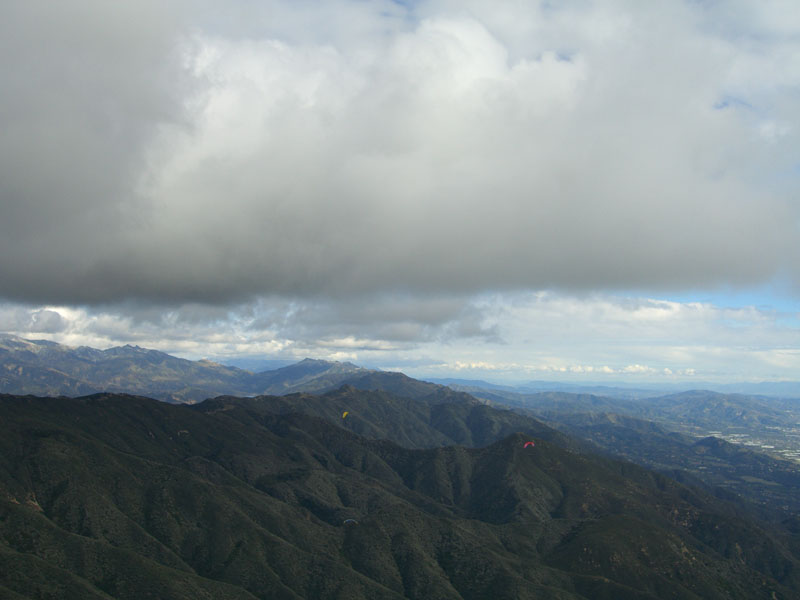

The gap to Montecito Peak (right above the red PG) Photo: Fly Above All
So now you’re above 4k on top of the TF getting ready to pull up anchor. If
you’re high enough, and the general wind pattern is NW you might want to
consider dropping back to the back range and then head east from there (SD
11/2011 Note: Paraglider Pilots are not advised to take the back route unless
your peak altitude is close to 6K and you are trying to follow a convergence
seam).  But
generally you want to set your sights on Montecito Peak. After leaving the TF
you will probably encounter sink but don’t panic, about 2/3 of the way to
Montecito is Shadow Peak. The thermals above Shadow are generally pretty
turbulent, and for the most part, don’t take you very high, but more often than
not, they will get you high enough to make it to Montecito comfortably.
The highest point of Montecito is on the west side. There is a distinct spine
there, but for some reason I always have a hard time dialing into anything that
will get me up and over the peak. Other pilots don’t seem to have the same
problem, but I always seem to have to fall off to the lower east spine, which
luck would have it, is a pretty reliable thermal generator (except when there is
a NW wind; then it’s best to stay back and work the peak itself). Unfortunately,
if you flush off Montecito low there aren’t a lot of landing options. These two
are considered no nos, but if you absolutely needed to use them in an emergency,
Westmont College and the golf course in Summerland are options.

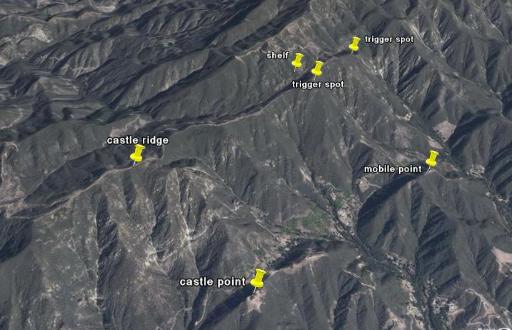

It’s a fairly short glide across Romero Saddle to Castle Ridge. The lift on the
west end of the ridge is similar to what is found above Shadow and West Romero,
but things open up a bit when you reach the east end which is marked by a jagged
peak. If you’re not getting up at the rocky peak it is not a bad idea to hang
out a bit to wait for something to pulse through. If not, I’ve had a number of
low saves above Mobile Point so you still have that option to keep you in the
ball game. Just a note here: if you find yourself even with the tops of either
Mobile or Castle Point its time to head out. From Castle Point the landing
options include the practice polo field and Santa Claus lane. From Mobile, Santa
Claus lane and, if you’re getting a good glide, Lynden Park in Carpinteria.
Immediately east of Castle Ridge the back ridgeline splits to create a shelf.
Like the road cut on East Romero, it is a good idea to have the altitude to come
in at least even with the top of the shelf. I don’t know if they have names but
there are two points toward the east end of the shelf that work great as long as
you come in above them. You really want to stop here to work the lift for all
its worth. I generally find more thermal tilt here than anywhere else along the
range. The lift just seems to want to take you up and over the shelf to the back
ridge line. Flush off here and Lynden Park and Bailard are your LZ options.

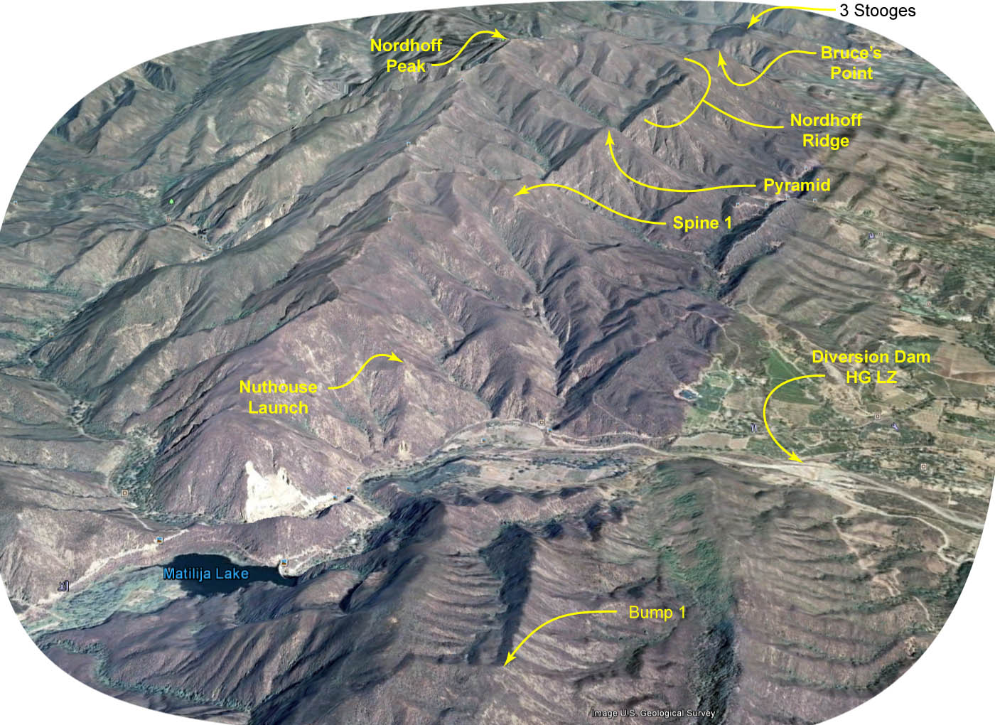

From Whiteledge you want to head directly over to Bump 3. It’s hard to tell from
the GoogleEarth image, but Bump 3 is about halfway to 33 and is marked by a flat
top and a red dirt face. Work this area for all it is worth so that you can come
into the Topas as high as possible. Having said that, you can get pretty low on
the Nuthouse spine, and the start of the Topas and still manage to keep your
flight going. Also, the end of the range on the west side of 33 is sometimes
good for a little boost. The Diversion Dam and wash are your LZ options.
It’s tough going if you come in low on the Topas, but if you are able to hang in
there long enough something will eventually pulse through to get you up and out.
Once you are able to get around to the front of the Pyramid things really open
up. All of the front points just west of Nordoff seem to work, however, I often
find the main spine coming down from the peak itself too turbulent so I’ll skip
it altogether and head directly over to Twin Peaks, even if I’m low. I have
found that Three Stooges is very reliable and can count on it working to get me
to the other side of the wide canyon.

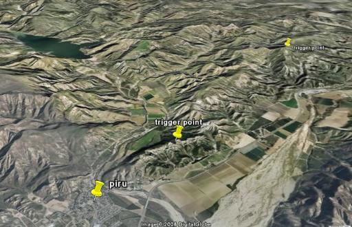

From Santa Paula Peak on you’re on your own. Of course you want to be as high as
possible when leaving the east end, but I really can’t say if it is better to
head to the high point of Oat Mountain or out to the front points above
Fillmore. I will say that the times that I’ve stayed in the mountains I found
myself on the wrong side of the ridge east of Piru. For my one and only flight
to the Interstate, I stayed out front both in Fillmore and Piru.
