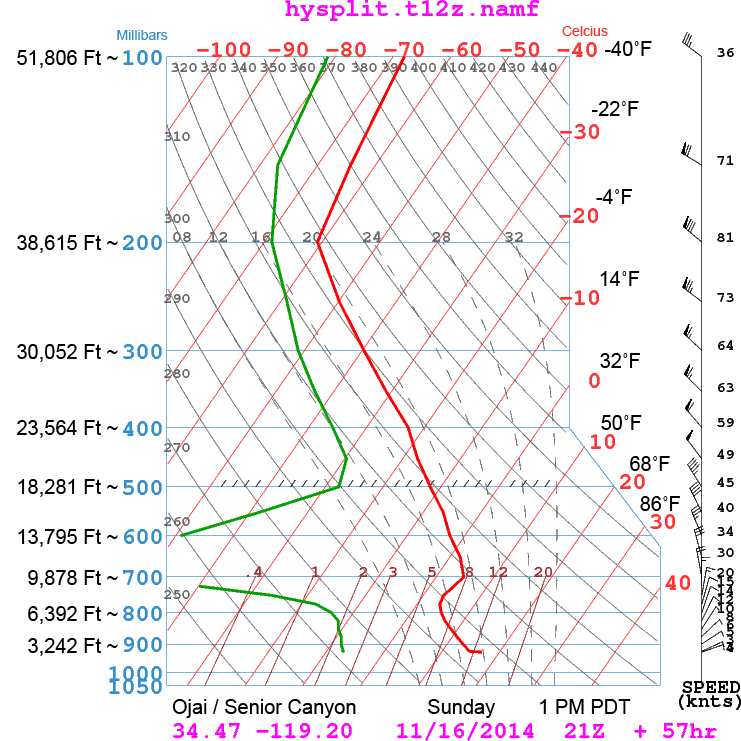

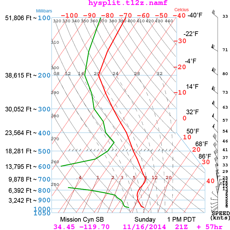

Friday Noon look at Sunday
Sunday looks like the better day, but there is a sharp inversion starting about 6 or 7K in Ojai and much lower in Santa Barbara. Wind is from the west in SB, but from the East in Ojai. Would probably recommend launching from Ojai because the lift looks stronger and the altitude looks significantly better. Plan on flying west initially, but turning around when you encounter west wind either over Casitas Pass or west of Casitas Pass. Not sure if anyone has a permit. You might want to check with Chris Grantham at Fly Above All, or you can a reserve at permit with the Forrest Service up to about 3:30ish today. I think they are open till 4:30, but they don’t like last minute calls of Friday afternoons. They are closed on Saturdays. SB looks good down lower, but the lapse rate flattens out above 3500. If you launch from SB and are able to get to the power lines, expect the altitude to get better at Noon Peak and you can probably make it over Casitas Pass.
Santa Barbara NAM forecast for 1PM Sunday
Ojai NAM Forecast for 1PM Sunday
