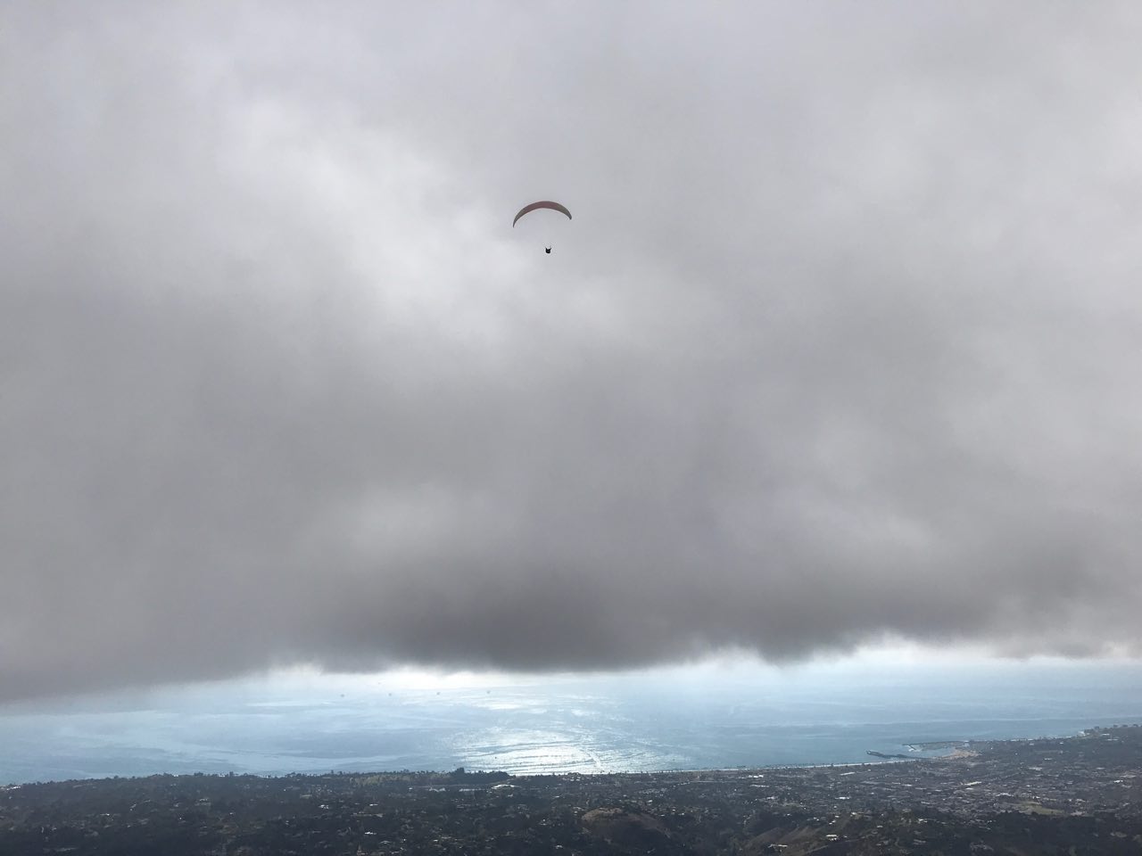

Looking SE at the Rock by Cracka
Looking SW across the Monastery Tear Drop by Cracka

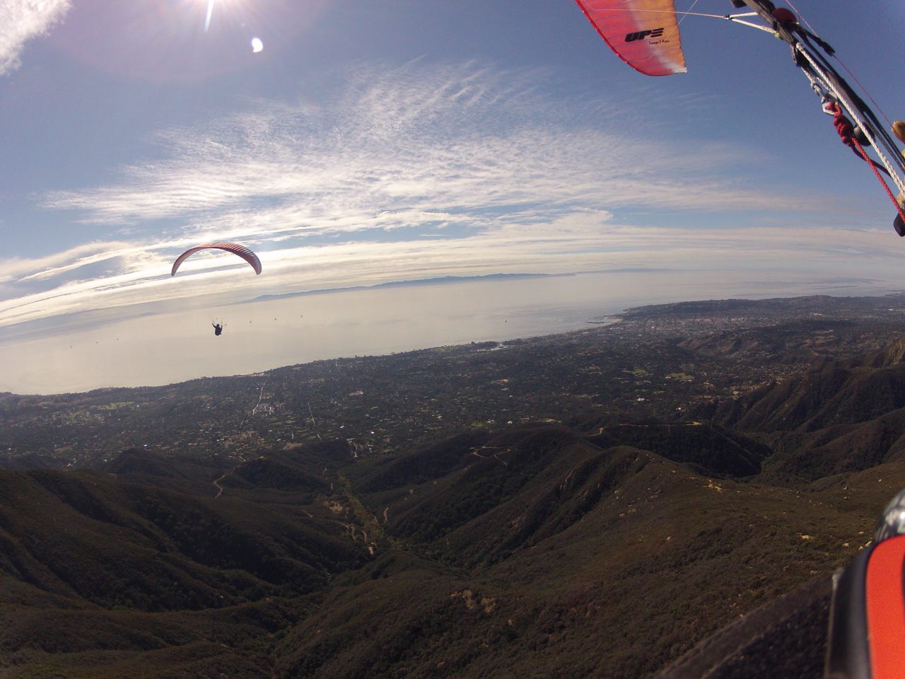

Looking south across Polo Ridge by Peter Weldon
_________________________

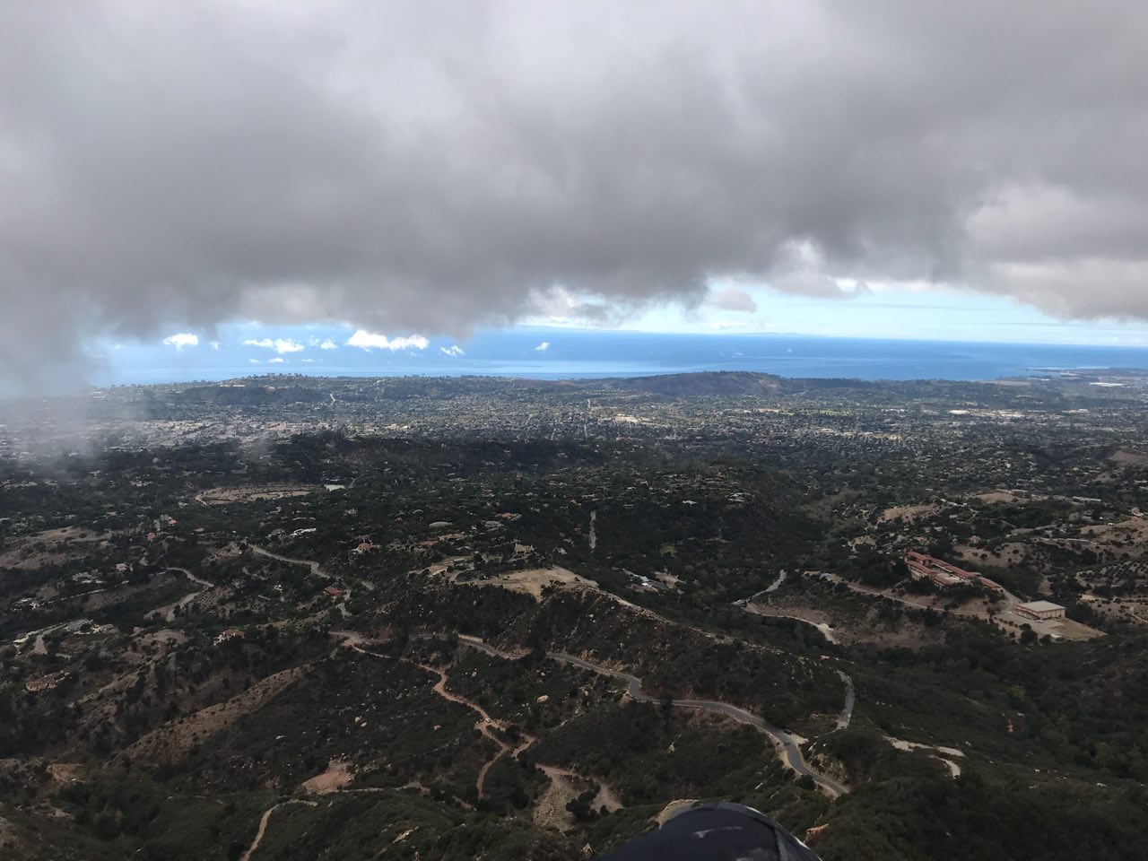

Trainin hill was crackin yesrerday too! / Looking SW from Elings by Cracka

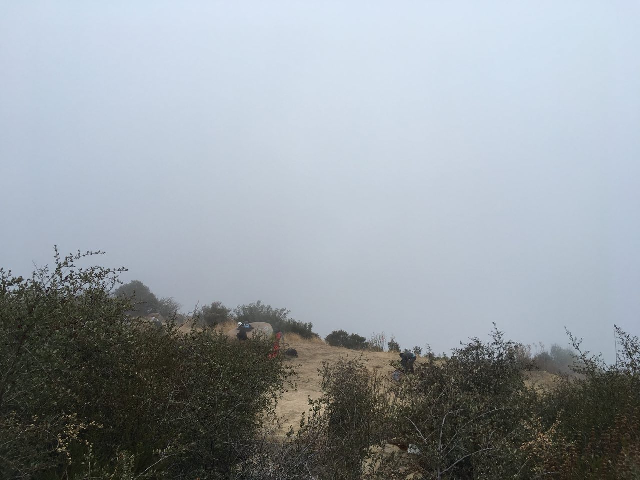

Looking South from the AF / Posted by Cracka

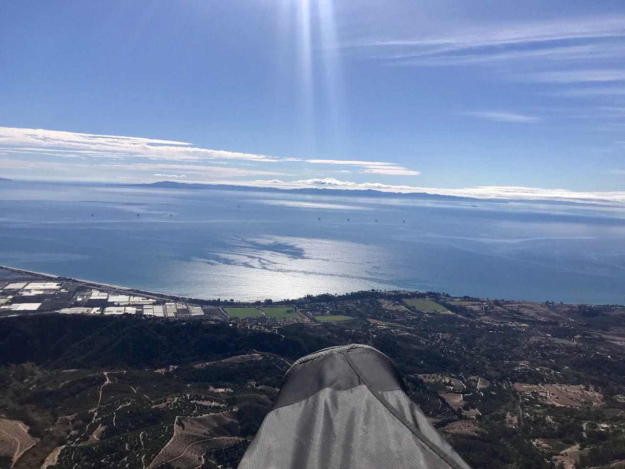

Looking East past Parkers by Cracka
View from Rincon Mt looking WSW taken at 12:40 by Black Ops

Looking north from the AF by Irene Revenko
