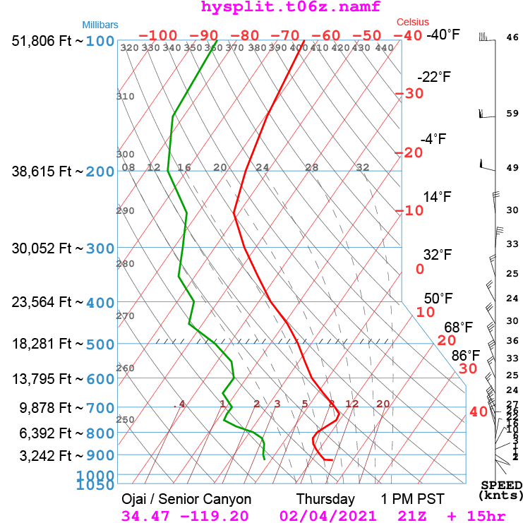

06Z NAM Skew-Ts for SB (10 AM and 1 PM) and for Ojai (10 AM, 1 PM, and 4 PM)
