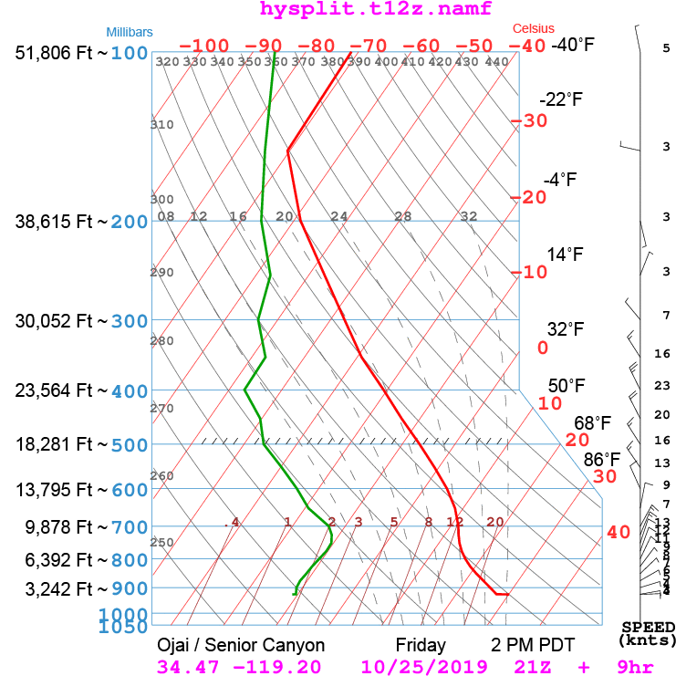

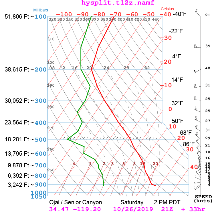

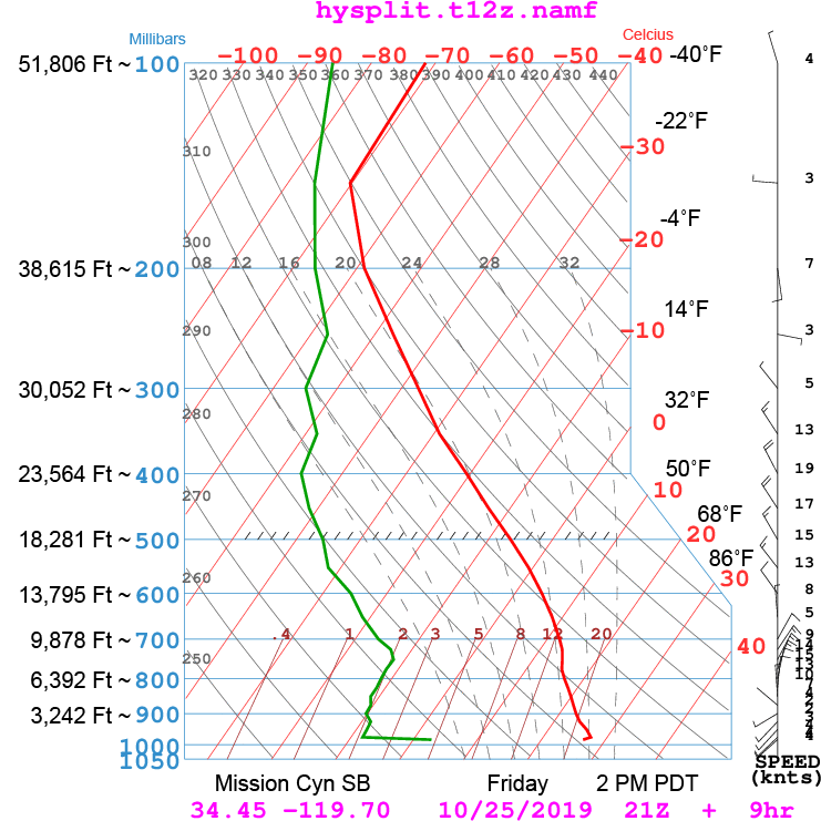

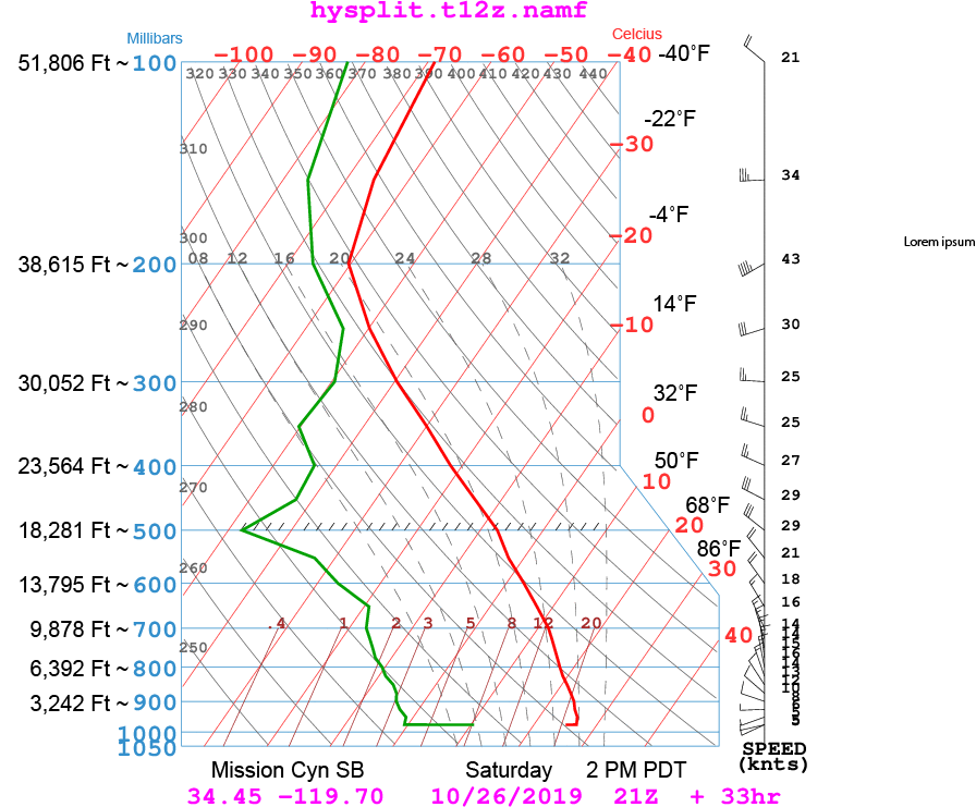

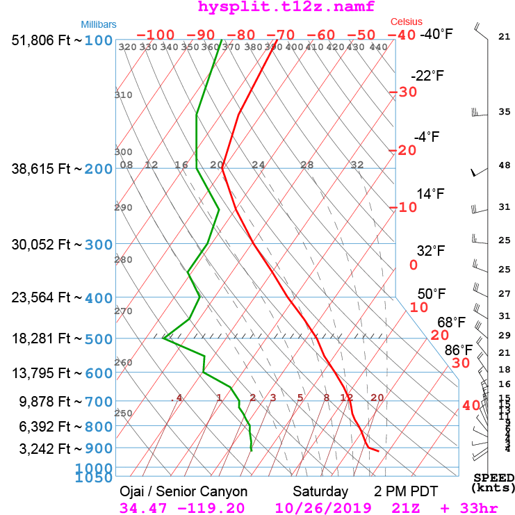

Postby sd » Fri Oct 25, 2019 12:37 pm
Great write up Derek. Good to see you and Chris raising a torch to shed some light. I try to learn by being open to differing perceptions. No forecast is perfect, so we need to be willing to be always a little wrong, and sometimes completely off the mark, but our aim will continue to improve as we tune in on all the variables of the ever-increasing data available.
I did a quick review and concur with most of Derek’s perceptions, but would likely have preferred to launch from Ojai on Friday (which is Monday morning quarterbacking about Derek’s Thursday forecast after I’ve had the luxury of viewing Friday’s midday observations), then by Saturday SB seems like the better call to maximize XC potential? Sunday seems to be switching back to an offshore Santa Anna influence.
Friday 2 PM Skew-T for Santa Barbara
Friday 2 PM Skew-T for Ojai
Saturday 2 PM Skew-T for Santa Barbara
Saturday 2 PM Skew-T for Ojai
