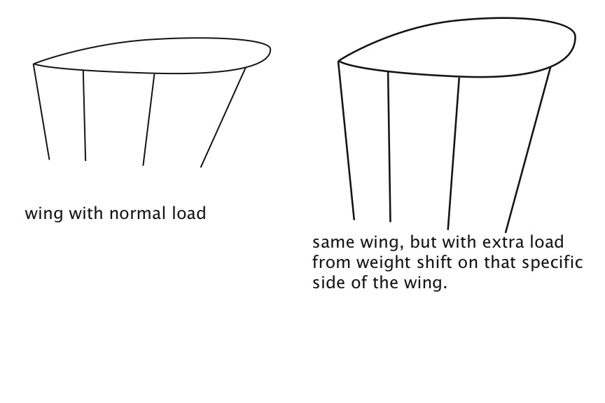

I am mostly writing this to solidify my own understanding of paragliding, and for others to criticize as they please. So to start, here's a sketch did in Illustrator.
From what I have deduced, added weight to one side of the wing alters the profile of that half of the wing. This creates more drag for that side of the wing, without changing the angle of attack, while the other wing counter-actively becomes more aerodynamic and accelerates faster than the loaded wing. The sketch is an exaggeration of a wing profile and a loaded wing profile.

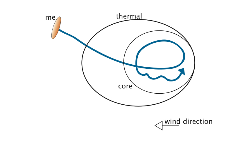

Now here is my thermal technique
This is exaggerated as well and will always change with the weather. It's an illustration of me entering a thermal, finding the high pressure system at the edge of the thermal, doing two 180 degree turns in the core, then dragging out my upwind leg as much as possible. On the upwind leg I increase brake pressure to a little less than minimum sink and gently shift my body side to side. I have always been told to use linked 360's, but haven't been one to abide by that.

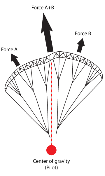

Simon wrote: ....
From what I have deduced, added weight to one side of the wing alters the profile of that half of the wing. This creates more drag for that side of the wing, without changing the angle of attack, while the other wing counter-actively becomes more aerodynamic and accelerates faster than the loaded wing. The sketch is an exaggeration of a wing profile and a loaded wing profile....
Simon, I believe that your conclusion is inaccurate :? . The weight shifting does not "alter the profile" (airfoil cross section geometry), but the overall airfoil symmetry. Weight shift actually does two things at the same time - it shifts the center of gravity and creates "imbalance" in resulting lift vector of an airfoil (parallelogram anyone?). I think you can conclude in which way my illustration will start to turn :wink:.

Postby Simon » Fri Nov 21, 2008 6:48 am
I can go along with that, thank you trifco.

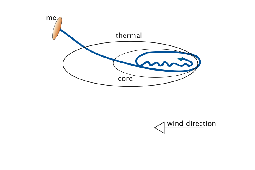

Here's another thermalling illustration
It's a variation of the last drawing. Thermalling like this gained me about 1000' when i was only a couple 100' over Bruces Point. I may have completed three 360 degree turns, dragging out the upwind legs.
